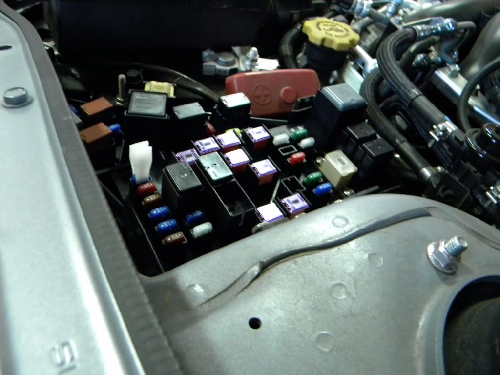

1. Pull the fuel pump fuse and start the car and let it idle to release fuel pressure.

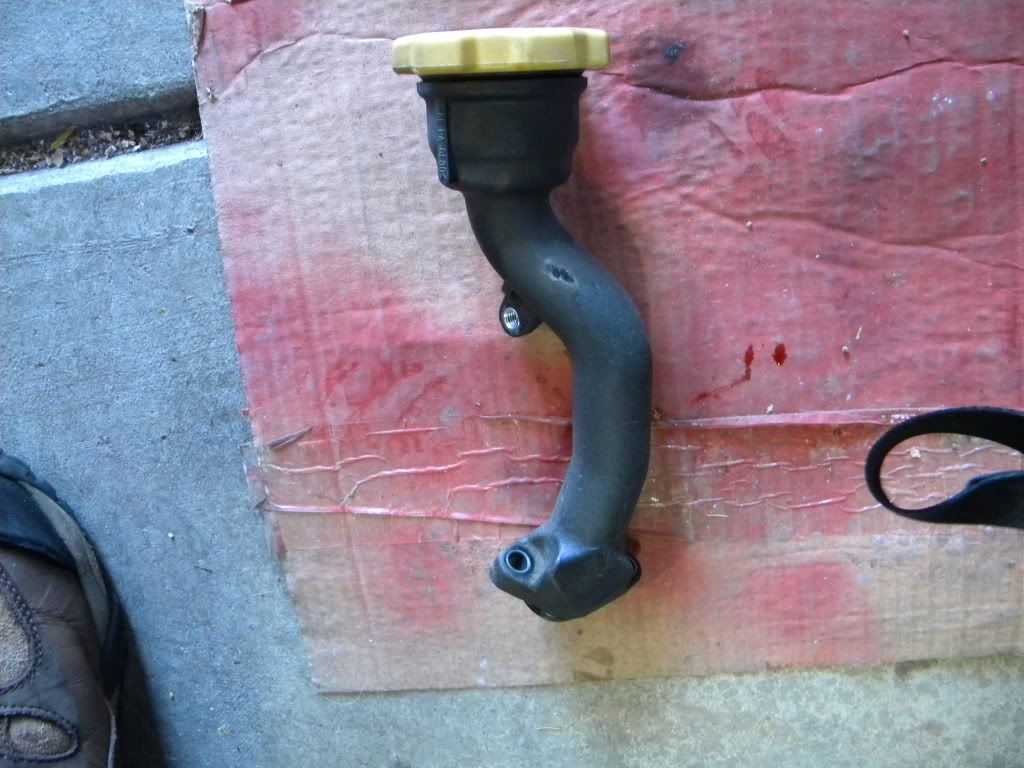

4. Remove oil filler neck. Cover opening with shop towel. 3 bolts 10mm. 10mm socket, 10mm ratcheting wrench.

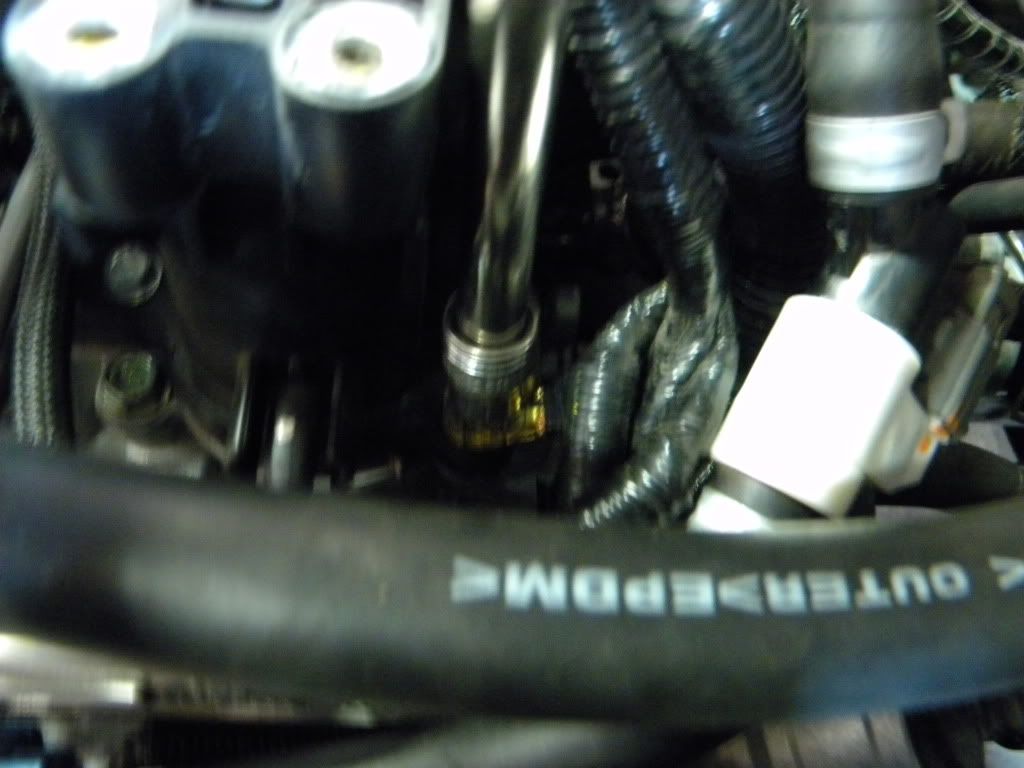

5. Remove Air pump. 2 bolts 12mm socket, pliers to release clamp.
6. Remove Drivers side TGV Motor. 10mm socket a ¼” drive with 3 inch extension works best.

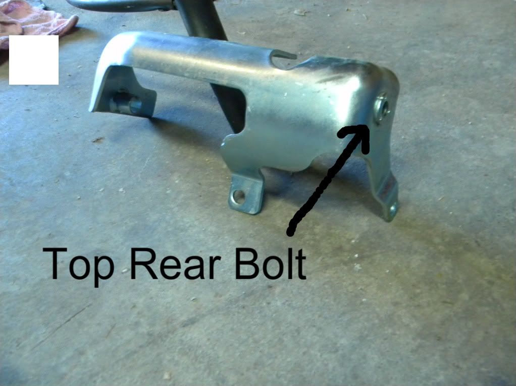

7. Bracket of death!
7.1 front bolt 12mm socket
7.2 Bottom bolt 12mm with wobbler
7.3 Top Rear bolt with ground wires. 12mm socket with 3” extension

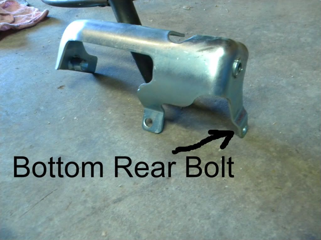

7.4 Bottom Rear bolt. 12mm ratcheting wrench. To break free, screw off by hand.
7.5 Removal of bracket off death.

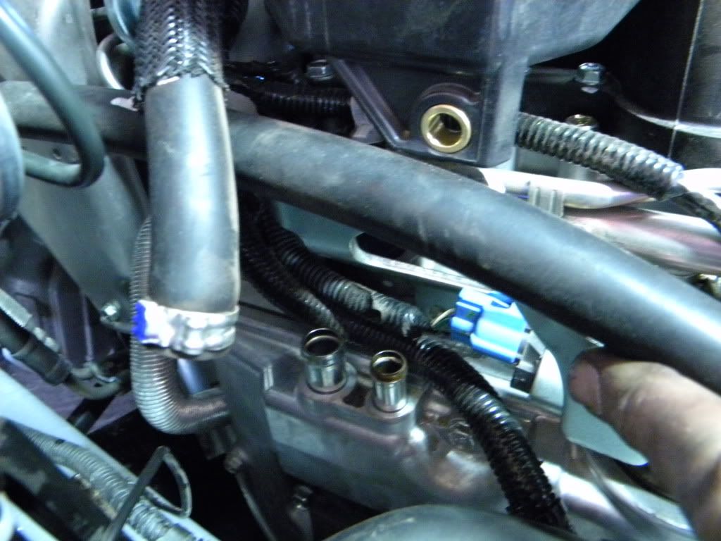

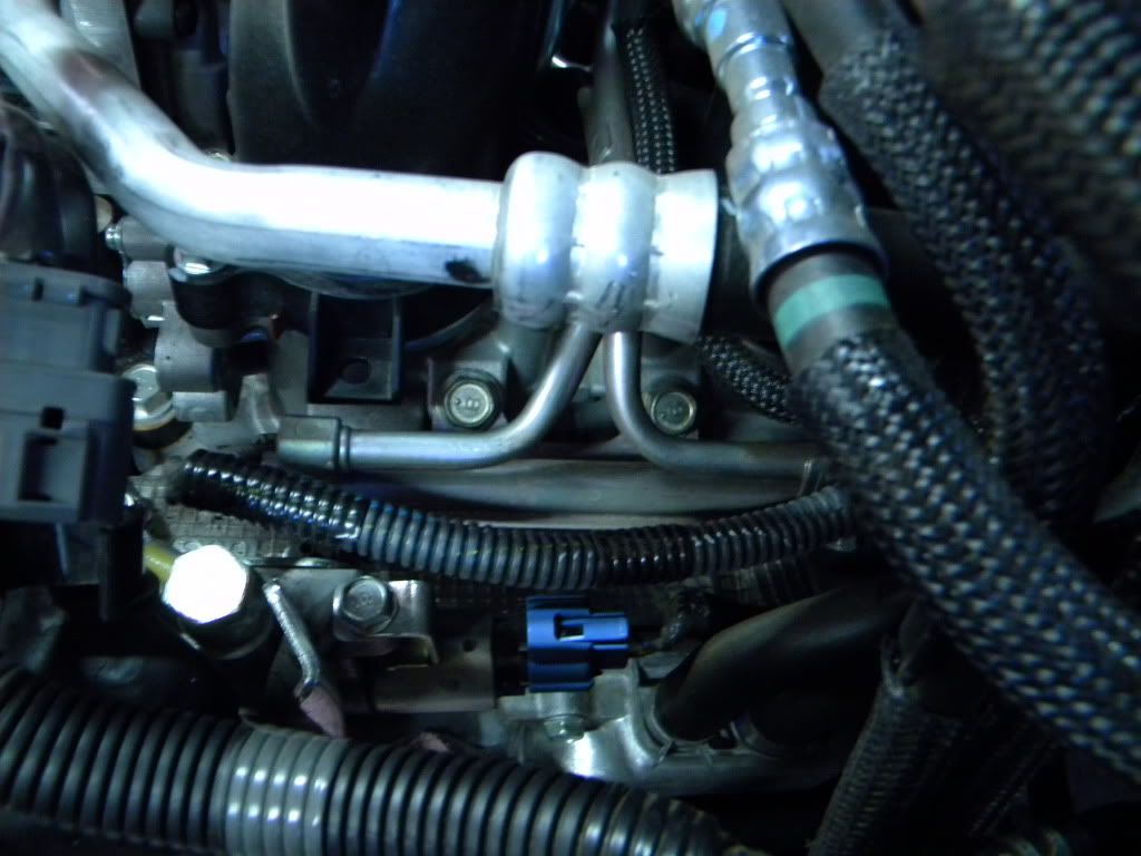

8. Remove bolts that hold the fuel rail to the tgv. 2 12mm bolts and 1 10mm that holds the rail to the top of the intake manifold.

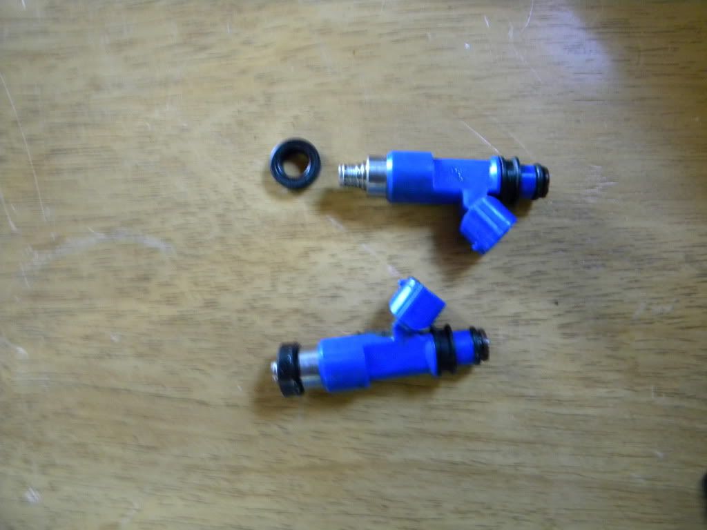

9. Lift on fuel rail and push down on injector to remove from rail pull the injector out and disconnect from plug. The bottom injector seat may be stuck in the tgv. Pry this out with a skinny flathead screw driver or pick unless you are planning on reusing it.
10.Installing the new injectors. It is best to apply some synthetic grease with PTFE or petroleum jelly to the top o-ring to easily slide into the rail. Just a very small amount will do. Place the fuel injectors in the tgv housing and push the injector into the rail, be careful that everything is sealed to the fuel rail. The top o-ring should provide a tight fit so that it cannot be too easily pushed out of the rail or fall out of it.

15. Reinstall Oil Filler neck.

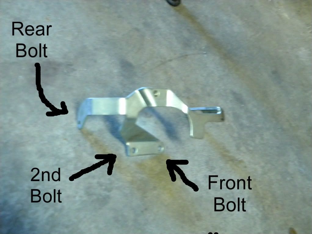

20. Bracket of death removal
20.1 Front Bolt. 12mm socket a wobbler may be helpful
20.2 Second Bolt. ¼” universal joint and 12mm socket. Also a 12mm crawfoot can be used to break free. Spin out by hand. The crawfoot may be needed to break free.
20.3 Rear Bolt. 12mm ratcheting wrench.

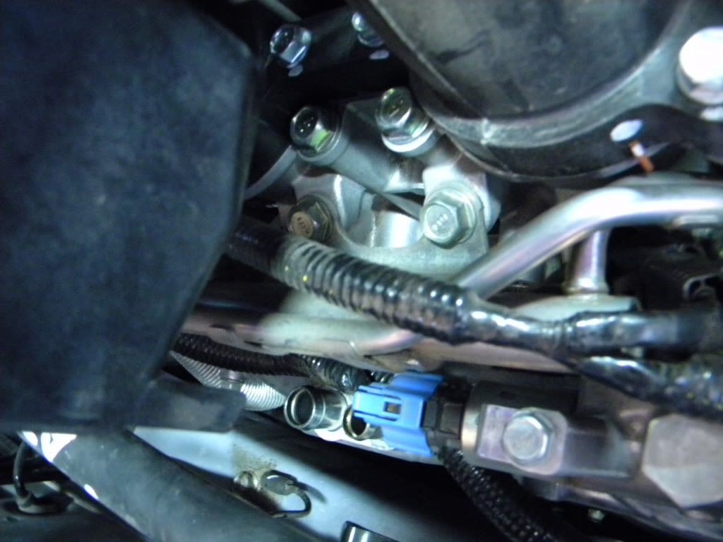

22. Unbolt fuel rail. 2 12mm bolts.
23. Injector Removal. You will need to slightly bend up the fuel rail to remove the injectors. The right side fuel injector will have to be disconnected from the harness before you remove it. The bottom injector seat may be stuck in the tgv. Pry this out with a skinny flathead screw driver or pick unless you are planning on reusing it.
24. Installing the new injectors. It is best to apply some synthetic grease with PTFE or petroleum jelly to the top o-ring to easily slide into the rail. Just a very small amount will do. Place the fuel injectors in the tgv housing and push the injector into the rail, be careful that everything is sealed to the fuel rail. The top o-ring should provide a tight fit so that it cannot be too easily pushed out of the rail or fall out of it.
