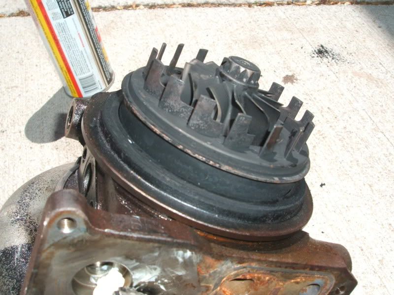

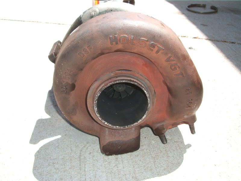

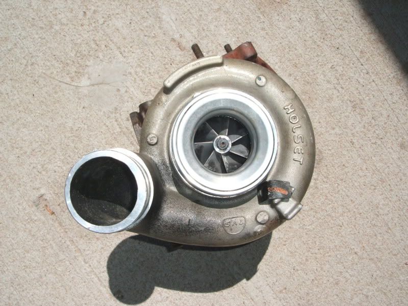

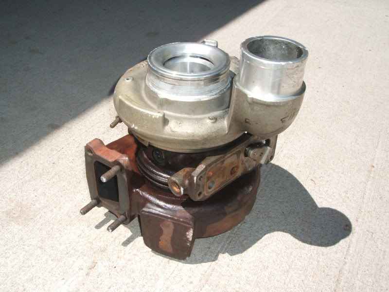

I finally cracked open the turbo and shot some pics of HE351VE
Turbine dimensions
exducer ~60mm
inducer ~70mm
Basically the turbine is a right in between a 35R and a 37R
Compressor Dimensions
exducer ~86mm
inducer ~60mm
Basically a little bit bigger than a Garrett 82mm wheel found in the 35R. Compressor maps seem to show airflow to be around 66-67 lbs/min.
my hopes are that the VGT function that changes the exhaust housing enough to quickly spool this thing. A/R is variable from somewhere around a Garret .25 to 1.9 A/R. People have had descent results from .63 A/R 35R's so I think I can spool this baby well below 4000 RPM.

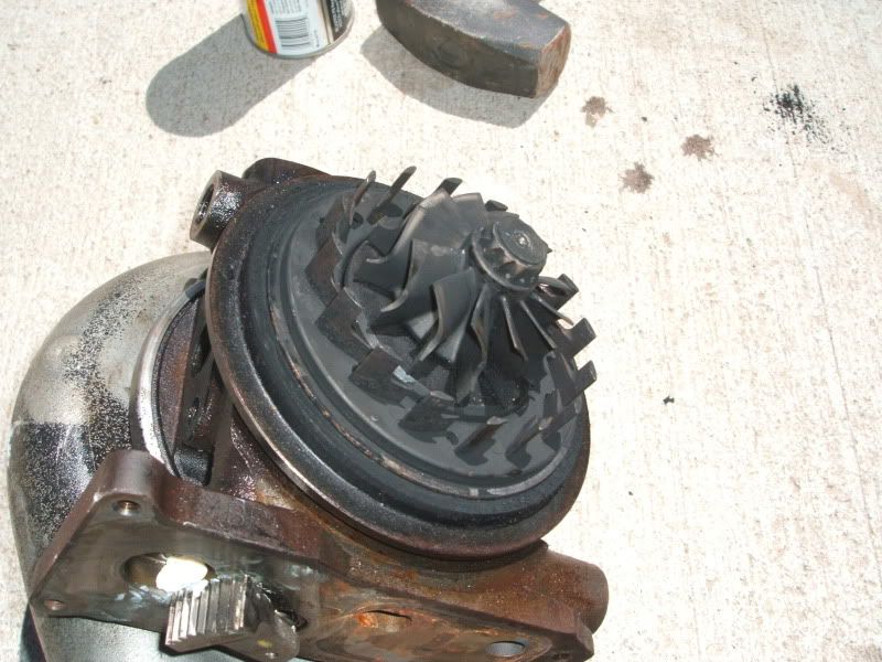

Vanes Fully Open(About a 25cm^2 exhaust housing)
Vanes Fully Closed(I am hearing from this is anywhere from a 2.5 - 5cm^2 exhaust housing, maybe less) it should have no problem spooling this

Actually there is a shit ton on ebay. The reason why is they clog up and vgt function gets jammed. This was the issue with mine. I had to hit it with a hammer to break it free. Early on, Cummins was having the turbo replaced. So these turbo's started piling up at dealers. Later on they started a process for cleaning the turbo. The literally drilled a hole in the turbo, ran a cleaning solution through the turbo while the truck was running and then tapped and plugged the hole up. So the supply of these turbo's is diminishing slightly. Still ebay auctions are starting at $100 with $50 shipping. I had no other bidders so I got a turbo for $150. Even if this project never makes it's way to completion I will at least be able to rebuild it and make my money out of it anyway. And 150 is not a lot of investment.
I know there are a few diesel guys on here. Anybody know a good way to decoke and clean this turbo? This is my first step in the process. I may have to contact my turbo guy.
