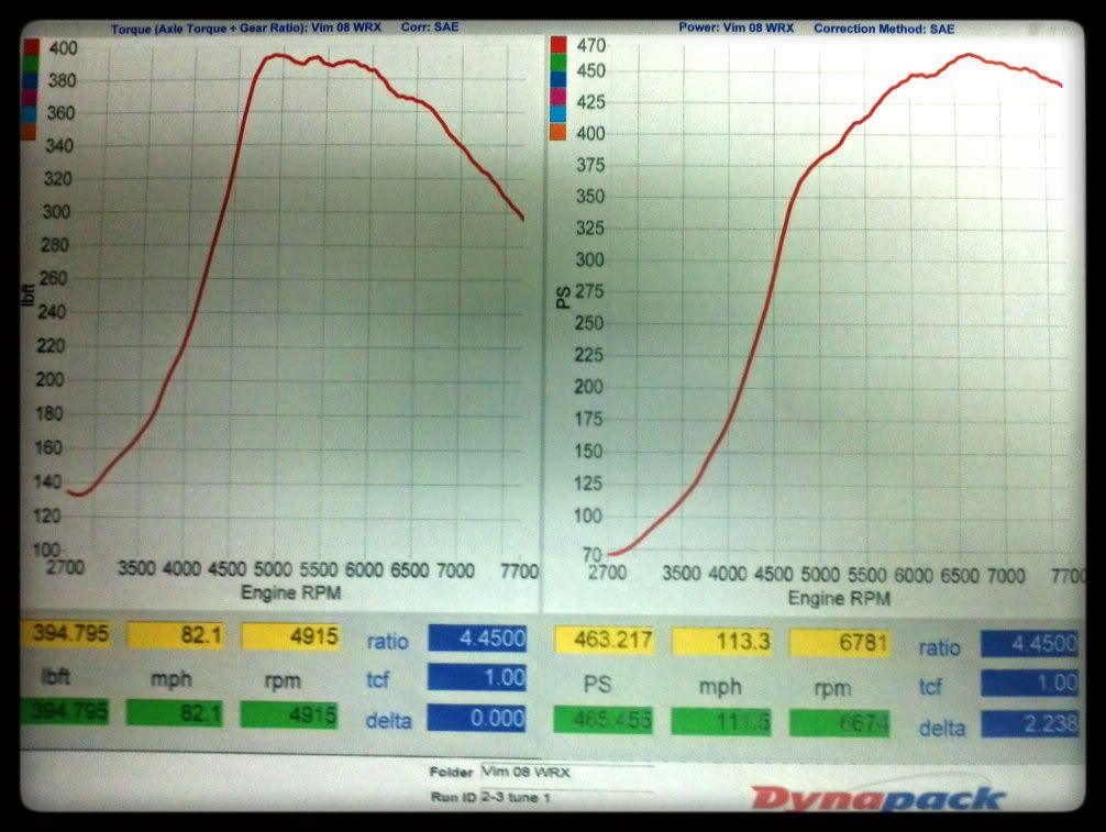

Welcome to my journey of transforming my once Base Model 2008 WRX Sedan into a ~2800lb 465whp Daily Driven Animal. To find specific sections, please refer to the directory further down in this post. It is still a work in progress.
Stock Power Output: 196whp & 236wtq
Stock Curb Weight: 3180 lbs
Stock Power to Weight Ratio: 16.22 lbs/whp
Dom3XTR Phase Power Output: 415whp & 390wtq
Dom3XTR Phase Curb Weight: 2748 lbs
Dom3XTR Phase Power to Weight Ratio: 6.62 lbs/whp
Current Power Output: 465whp & 395wtq
Current Curb Weight: 2748 lbs
Current Power to Weight Ratio: 5.91 lbs/whp

So, I took the car into Church's to get a custom tune. I discovered a few things while I was there. The stock turbo spools very fast and dies... very fast.
first and foremost, Shawn Church is the man. There are lots of boys and men in this world, but Shawn is THE man (it's dyno proven). Ask me if I'm religious, and I'll reply, "I believe in Church". This man works efficiently, professionally, and puts his heart in everything he tunes. I can'thelp but respect every aspect of the way this guy runs his business. Thank you Shawn. He was able to extract some serious torque from my Subie, and safely too! We hit a wall in terms of horsepower and Shawn pointed at the snail to take blame. The snail blushed.
The end result was wicked to say the least. Coast into a left turn in 2nd gear, stab the throttle just past the apex to 3000rpm and all four Kumhos progressively slide out and tighten the nose. The tail doesn't just sweep around using the front tires as pivot points... No. They ALL spin out. But it's not scary, it's almost like you've entered a slow motion mode, mid-corner in a video game, and you can now steer, countersteer, or just aim and shoot. It's so disconnected from the road, yet, so controlled.
Bog the motor early in first and feel that addictive boost rush punch your chest, pressing your heart against your spine. Then feel it coast to 6k rpm. Shift to second and feel a momentary pull, then again, a coast. Wait, why are we coasting during a flat out run through the first 3? Oh, I know why... No horsepower. Don't get me wrong, the power is there... It's just masked by tall gearing, obscene amounts of short lived torque, and just a lack of top end power. The car feels powerful, but unwilling to accelerate with any motivation. Capable, but lazy ('Brilliant but lazy' - Doc Oc). It will spin all four rubbers without a shrug when it hits peak boost, but it doesn't like to be rushed to red line. While I describe the acceleration with a significant amount of disappointment, don't believe for a moment that it is any less than it was before the tune. It's significantly stronger and smoother, I just expected a good amount more out of the top end. I figure an additional 30-40 whp in the mid-high range would really give this car a competitive advantage over most on the road.
Overall, it was a day that revealed to me my next and final step. The turbo needs to be changed out to accomplish my goal. My goal for this car is ~300whp and ~350 wtq. I fell short by a long shot in the horsepower department, but was close in torque output. The main reason for lower hp output is that the turbo just can't efficiently push any more air in the mid-upper range.

The Proof is in the Pudding! Church Tune vs PERRIN Stage 2 vs Stock
Blue line is Church's Custom Tune
Dark Green is the PERRIN Stage 2 Tune I was running
Light Green is a stock 08 WRX
Shawn was able to extract an additional 27.5 whp and 55.7 wtq from the PERRIN Stage 2 map which was already helping me make a good deal more power than stock!
Church Tune vs Stock
Note that Shawn made an additional 37 whp and 97.3 wtq over stock!!!!
This was the second best tune of the day... He hits 231 whp and 333 wtq
After tuning, Shawn rides along with you while you road test the car. He was kind enough to film me doing a 0-60 attempt with the new tune. Insert Excuse: I had recently adjusted my seats and hadn't done a launch with the new positioning, hence I was unfamiliar with the clutch engagement point. Long story short: I rode on the clutch until midway through first. No 0-60 time was recorded. At least it SOUNDS good, Yum!
What's Next?
Shawn showed me a dyno that inspired me. He was able to get an 08 STI to put out over 290 whp and about 340 wtq with only intake and cat-back. The spool up was about 500-700 rpm later, but hit hard and held well! The horsepower figures held nice and high to redline... He suspects it will make at least the same if not more power on mine since I have a high flow downpipe. The vf48, however, does not bolt onto my 08 WRX. Instead, I need to obtain the vf52 which has the same internals, but wrapped in a Legacy/WRX friendly housing. The vf52 is the turbo used in the 09 WRX, and is capable of comfortably making 280-320 whp. It will have more lag than my current application, but with thrusting power all the way to redline, it's a small compromise I'm willing to make.
The 09 WRX also shares the same injectors as the STI. This fact serves as a clue for me to get the STI injectors as well before I get this bad boy retuned. I will be out an additional 1500-1700 in total, but the car will be more than fast enough to run LOW 4s 0-60, and should be capable of 12s in the 1/4 mile.
I'm just waiting for the right deal on the new snail, but I will keep everyone posted. Thanks for following along my journey! :)
