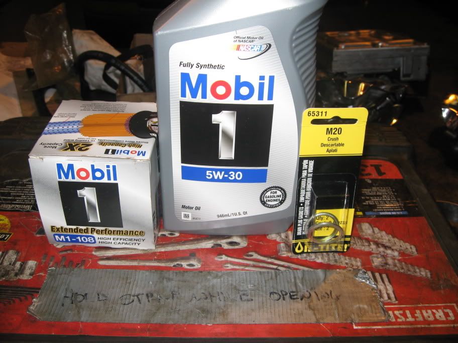

here is what i used to change the OIL (not the tools)

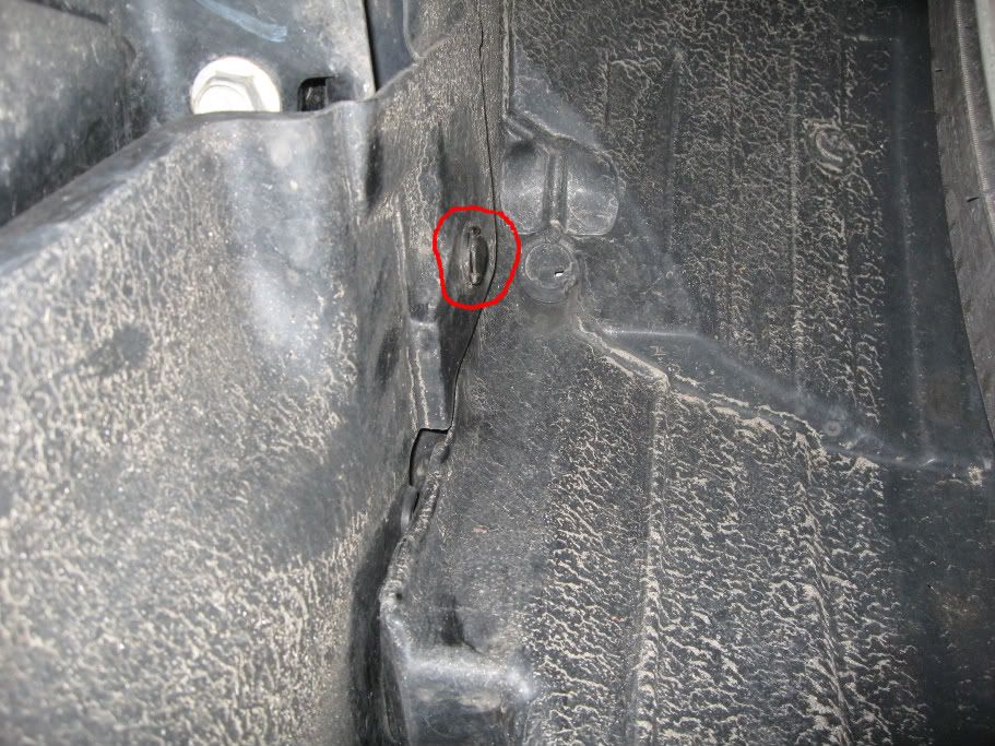

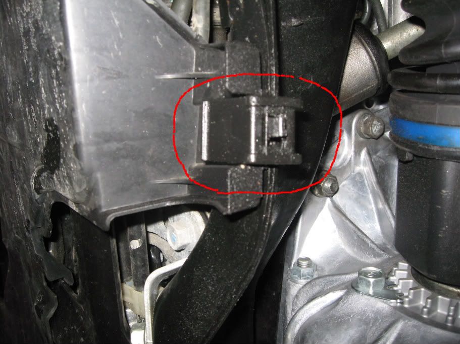

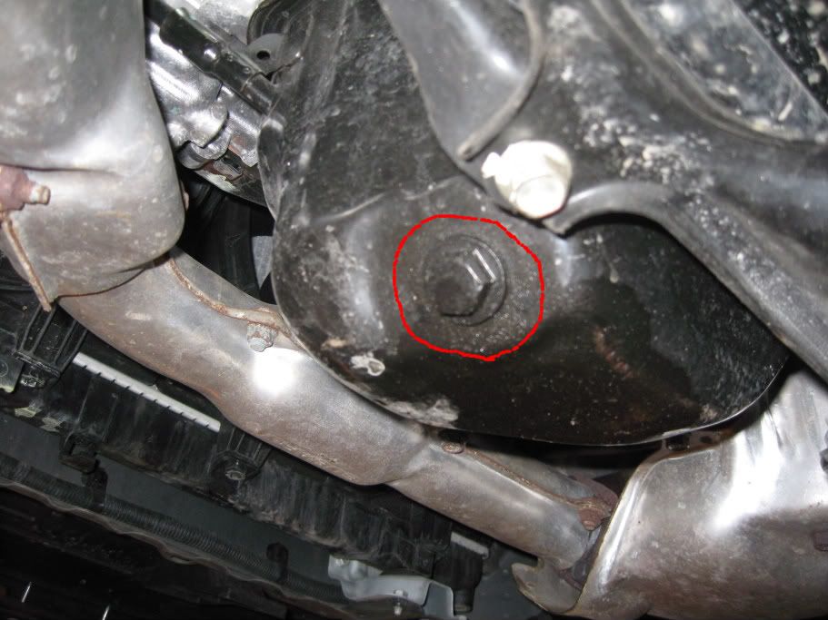

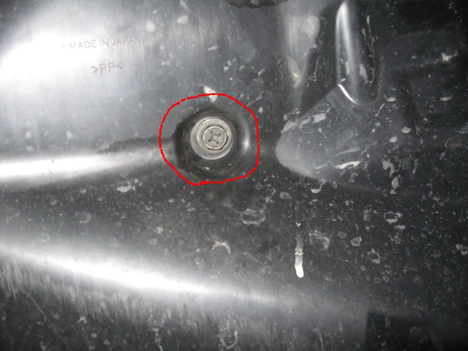

the skid plate has 3 bolts and 4 plastic clips 2 on the bottom back of skid plate and 2 on the sides (here is 1 bolt in the back of skid plate and 2 clips)
the clips on the back of the skid plate ( i just pulled them of easy and simple)
here are the clips on the side of the skid plate betwen the weal and the fender (here 1 on each side) u can use a flat head to take them out
this are the bolts on the front of the skid plate (there are 2 of them 1 on each side left and right)

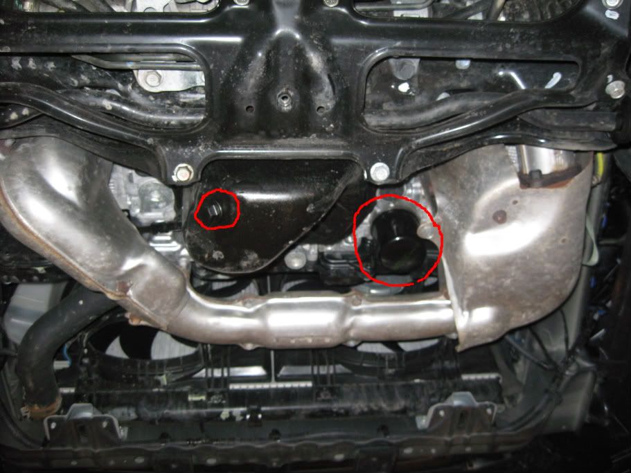

after you got the skid plate of here is how the car looks ( on the left u see the bolt that drains the oil and on the right u see the oil filter)
take the bolt that drains the oil out and drain it

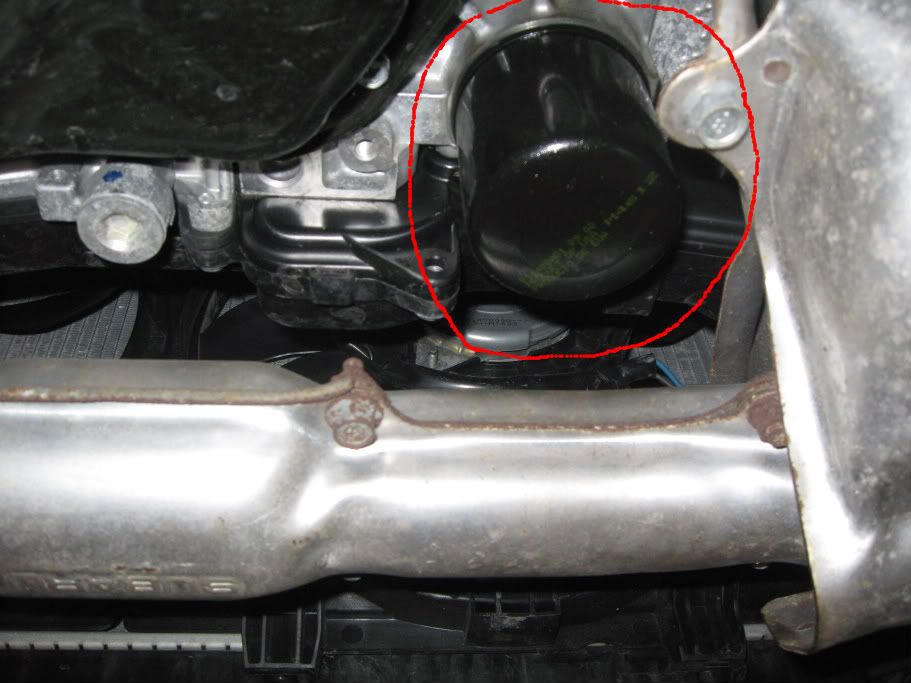

take the filter out and replace it (here in red) ((((( oil filters are hand tightend and what i do is fill it with a bit oil 1 time and use a bit of oil on the outside rim of the filter)

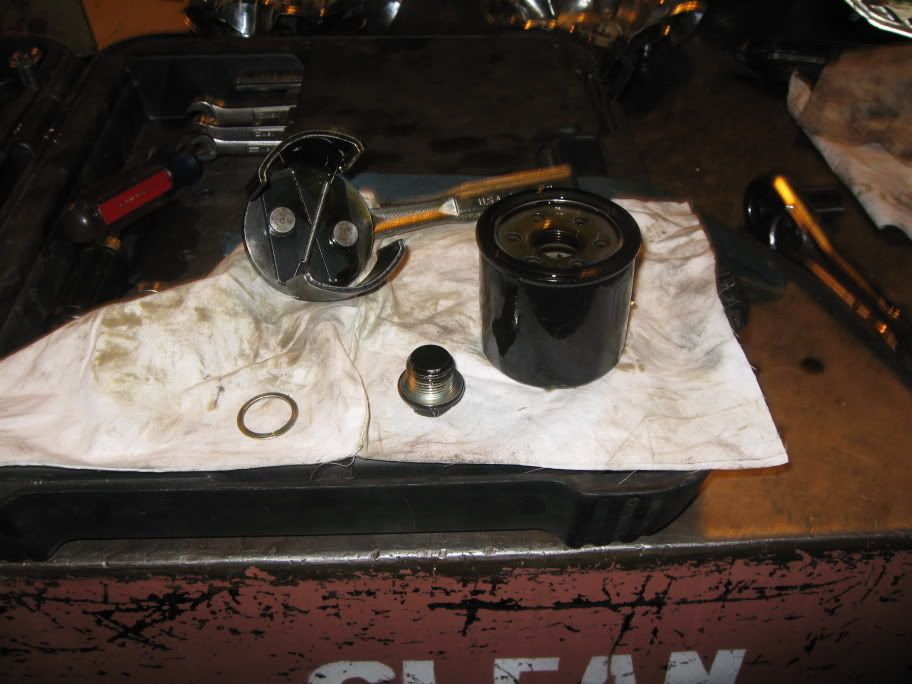

here is a pic of the old filter the oil drain bolt the m20 crush washer and the tool i used to take the filter of
