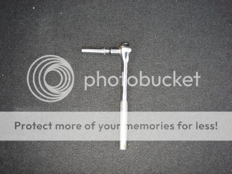

Tools needed/used: Deep Socket size 10mm and ratchet wrench.

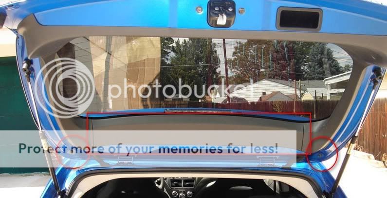

STEP 1: Open hatch and locate the 2 bolts on the far left and right (as shown circled in red). Remove these bolts as well as the plastic panel (red rectangle). The panel easily unsnaps. I started on the right and worked my way to the left.
Here is a close-up of the bolts that are on each side:

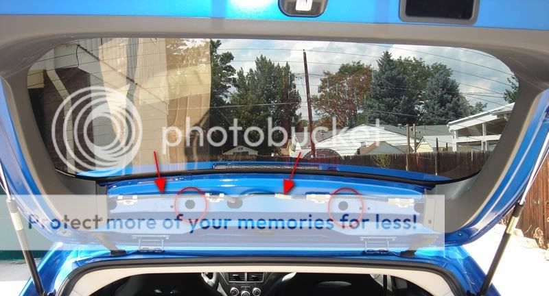

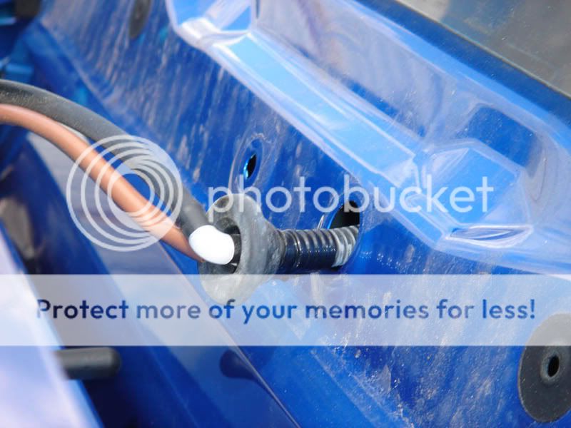

STEP 2: With the panel removed, you are now looking at the wiper hose and the brake light wiring. These need to be disconnected at the points indicated with arrows. Also note the holes circled in red. This is where you will need the deep socket. In the holes you will see the nuts that need to be removed. These tighten down threaded posts that are attached to the bottom of the spoiler. Remove the nuts and disconnect the hose and wiring.
The wiper hose and brake light wiring disconnected:

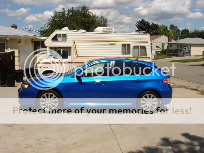

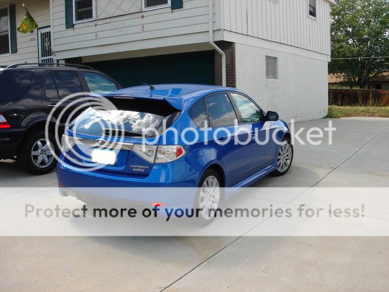

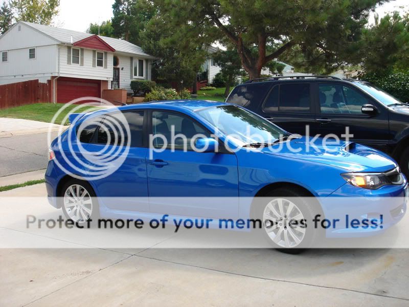

Before/After:

before
after
