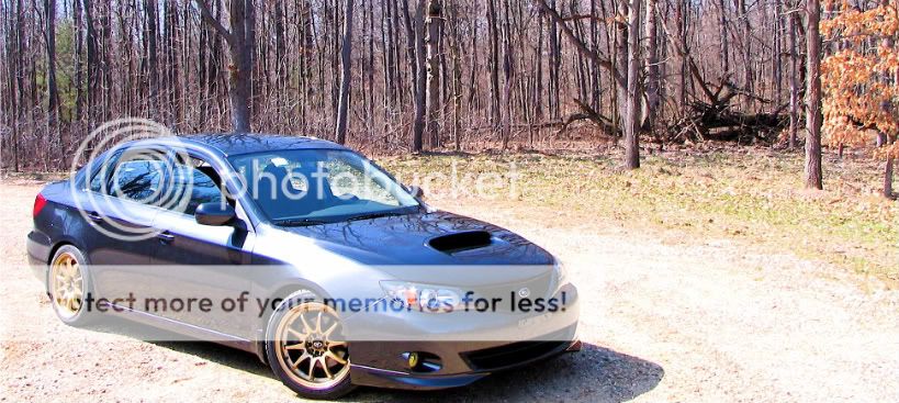

Quick update - I installed my FMIC yesterday, and worked out all the kinks today :D Currently, I'm just running it on the stock turbo and TP stage 2 tune. I just wanted to get it installed so there is less to do later. Here is one pic... I'll post some more pics of the install later when I get back to my apartment in Chicago where the internet is much faster. For now:
A big thanks to monkiboy for the super fast replies to my PM's with questions!

Nice photo and welcome to the fmic on stock turbo club!
Sorry to hear about your clutch issues. Fingers crossed its a nice simple warranty fix!
