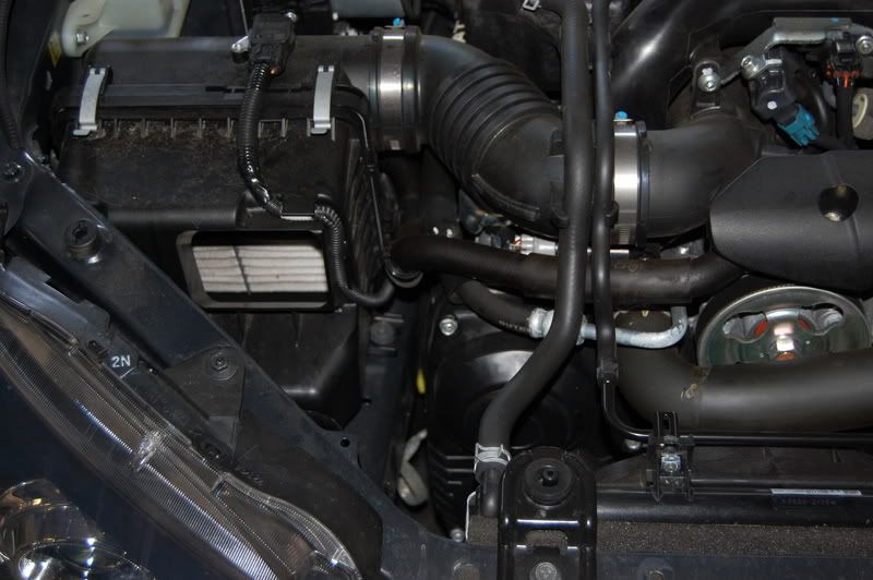

So after remvoing my MAF and testing it, i noticed that it is not strait in the middle.

Step 1: Pop your hood, gather all the tools listed above, and disconnect your battery.
Step 2: Remove air scoop by removing the two philips head screw things, place off to the side
Step 3: Remove MAF sensor by undoing the two philips head screws, Place screws in a safe place we wont reuse these, Plac ethe MAF sensor some where near by.
Step 4: Using a Flat head screw driver loosen the 2 hose clamps from the intake and airbox. Remove the rubber peice between the airbox and the intake. P.S. dont drop your pen inthe the bumper its pretty much impossible to get out.
Step 5: Remove rear side of air box and the air filter. To get the rear off pull lightly twords you and twist clockwise. Place off to the side, we wont need this anymore.
Step 6: Remove the 2 10mm nuts that are holding the rest of the air box in, remove the rest of the air box and place off to the side, we wont need this anymore. For the bottom nut use a 10mm socket with an extension, on the top one use a 10mm wrench.
