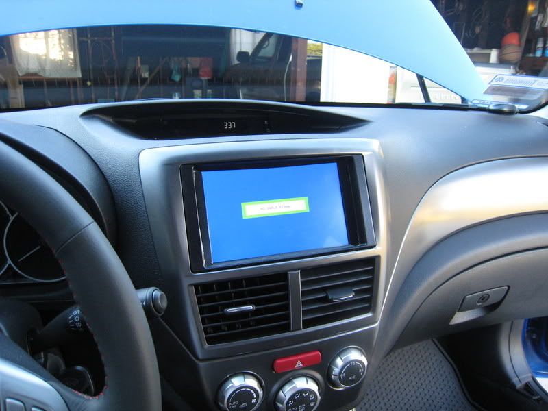

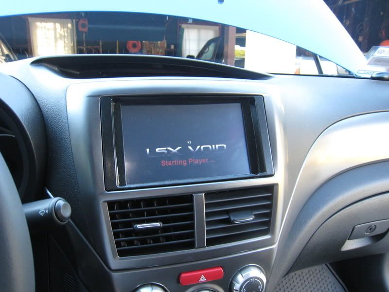

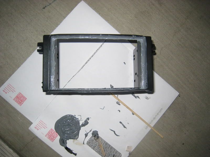

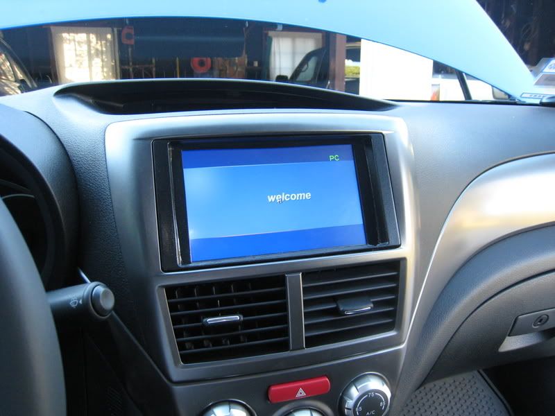

So I used to have an Accord and I put in a Carputer back in 2004. It was one of the best investments I had made since it gave me GPS, crapload of music storage, and abilities to do a ton of other things. So when I picked up my 2009 WRX, this was one of the first things on the list. My old system was really ghetto rigged and was this wooden box that sat in the trunk. I wanted to go for a stealthier install this time around since the trunk is smaller. Also, I wanted an intelligent power supply so I wouldn't have to keep hitting a toggle switch everytime I got into the car as with my old one.

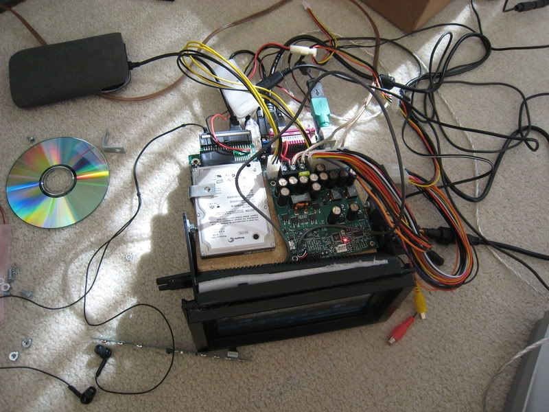

Components used:
Intel Dual Core Atom 330 Mini-ITX Mobo
2GB DDR2 RAM
Holux GPS Receiver
Lilliput 629 LED Backlit (2008 Model) LCD
80GB Seagate 5400.3 HD
DSATX 220W Intelligent PSU

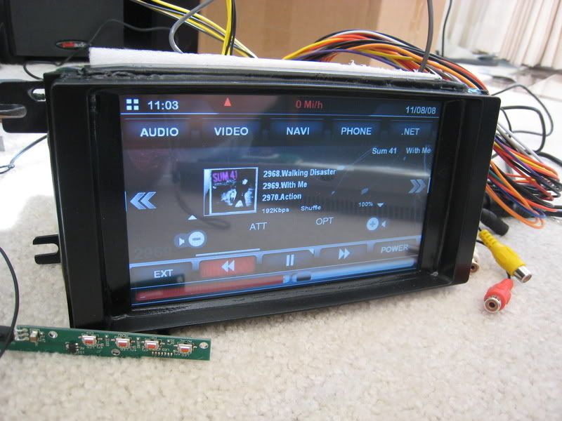

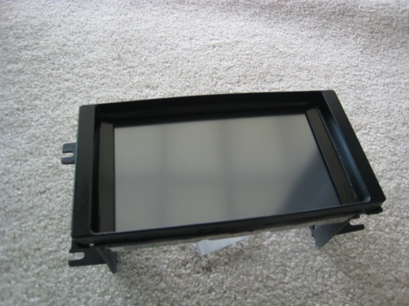

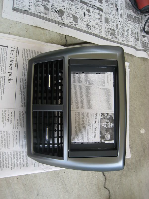

Test Fit and Fabbing
The above was with my old Lilliput 619 LCD that took a dump on me. The 629 is in the pictures below
Test bench

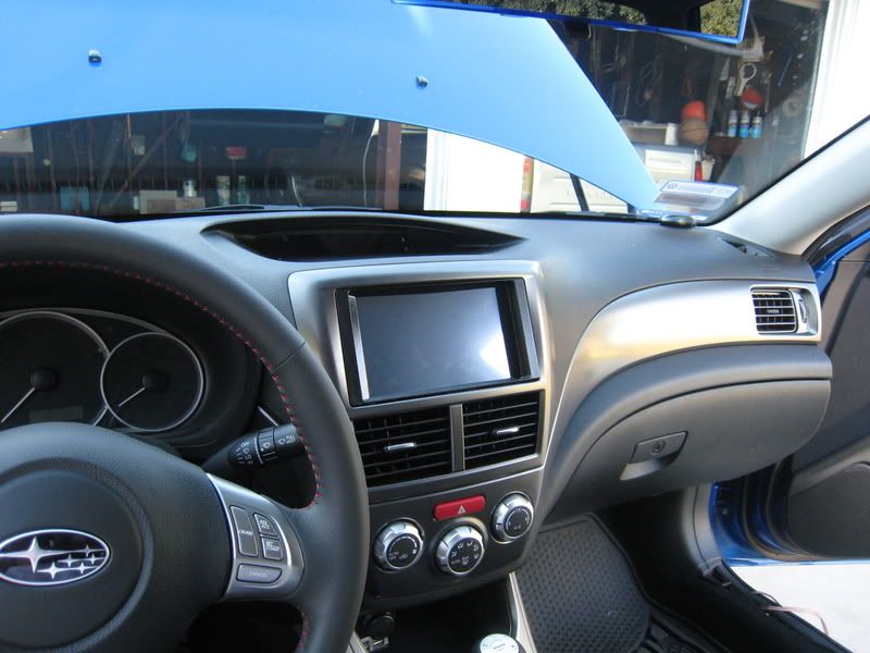

you managed to fit everything behind the dash?
Yeah...it didn't fit at first so it took some work. I routed the HVAC controls to go under the metal crossbar and snipped the ties that kept the bundle running on top of the bar. It was then a matter of massaging everything into place
