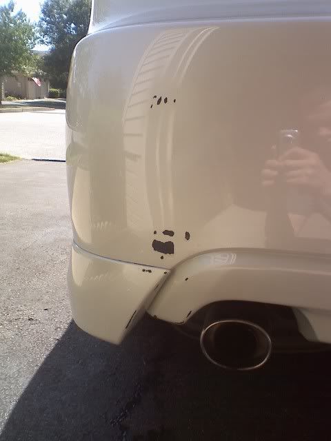

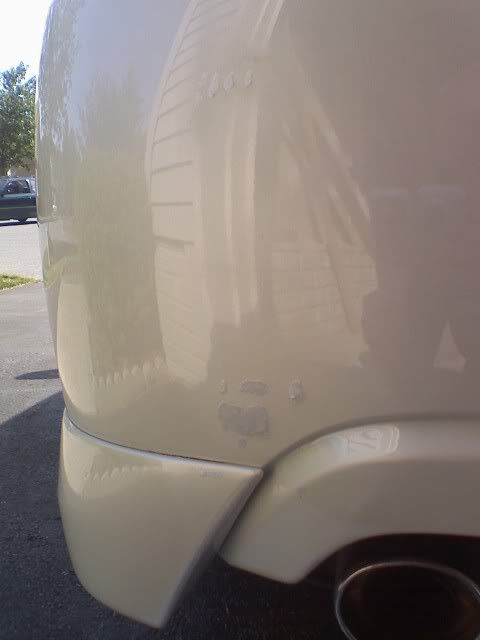

Hey guys. So im backing up yesterday and you know those stupid yellow cement poles that stick out of the ground to protect the building? Well the whoever decided to install those put 1 set in front of the building and then an additional set in front of that set. A million people must back up into them cause the 2nd set were all bent down towards the ground. So on with the story. Im backing up out of the spot i was in and the poles are so damn close to the spots as it is which makes it a PITA to back up safely. I back up and go into one of the effin poles and here a not so nice noise. I get out of the car and come to see a little bit of the rear ground effect has come off and I have multiple paint chips as well as yellow paint now on my car. I honestly have the WORST luck in the world. I went to subaru today and got some touch up paint and rubbed out the yellow marks. So heres a before an after pic of it. I didnt wanna bring it to a body shop cause theyd have to paint the entire rear bumper again and that would be a nutt price so i just did this instead. Let me know how horrible it looks... :'(
Before
After

If i were you, id sand the touch-up paint with super fine paper to help smooth it out. Then spary a little clear on it just to hide the flatness of the paint. Just my .02
949 Posts
the sand paper wont take the touch up paint off? and what grit sand paper do i use? then just spray a clear coat on to it?
1,362 Posts
Your not going to go full force on it, otherwise you would remove the touch up and factory paint, and thats bad ahah. with a very lightly use no less than 300 paper. For the clear, use a high quilty spray, do multiple coats or it could drip or run. Take your time and it should work out fine.

LMFAO I think you just got the 1st actual laugh outta me since this crap happend. Quick question. Do I spray just the part i touched up or the entire bumper. I know its prob a dumb question but just was curious lol.
1,362 Posts
Just do the part you sanded and touched up. Again take your time with the clear and make sure you clean all of the dust and dirt off before you use the clear.

dude get your bumper fixed at a shop... if you try to just spot spray the clear you gonna be able to see it, i do auto body, take it to a shop before you make fixing it right any harder...besides if you try to wet-sand the touchup paint down and dont know what your doind you will probally take the clear and base coat off in the surounding areas...

Heres my 2 cents- If your not to sure about how to touch it up take it to the shop. Other wise wet sand the touch up paint ( very lightly) then tape off the area your going to spray. ( apply light coats, don't rush it). After it drys hit it up with a cleaner wax then buff it out.
Wet sand paper is Black very fine grit sand paper and usualy found in the body repair section( where the paint, filler,ect) at your local auto store . Wet the sand paper and lightly go over the area your sanding.

+1 on taking it to a shop. Its a brand new car and unless you know what your doing its probably going to look like crap anyways. Plus those cheap paints dont really hold up all that well. But if your are going to paint it on your own, let me know and i could give you a better description of how to do it.

Too bad about your accident. I've hit my front spoiler on parking curbs twice. Twice! What an idiot! Anyway, the only one who will really notice is you. People see your total ride and they don't look for little spots. How many times have you seen a real race car that looks totally cool until you really look at it and you see all kinds of mess with the body work. My 2 cents is fix it up as best you can, you aren't going to make it perfect and then forget about it. When you get some extra dough and you don't need an up pipe get it fixed. I mean who's to say some one isn't going to hit it in the parking lot tomorrow.

Yeah zoid your rite. Thats what Im doin. Just doing it as best as I can. Almost done, Just finished applyig the clear coat. Gotta do like 2 more then wax it with the color restore and then wax the whole rear bumper. Id rather spend the money on something I really need! And your also rite about Im the only one who will notice it really till I actually point it out to someone or they look really really closely. At least it's towards to bottom and on the rear. Ill have a pic of afterwards up on here soon.
