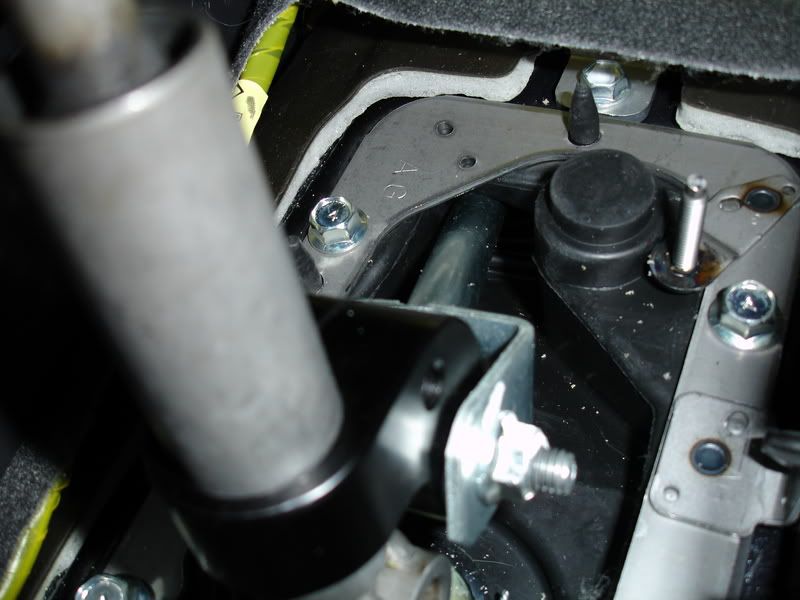

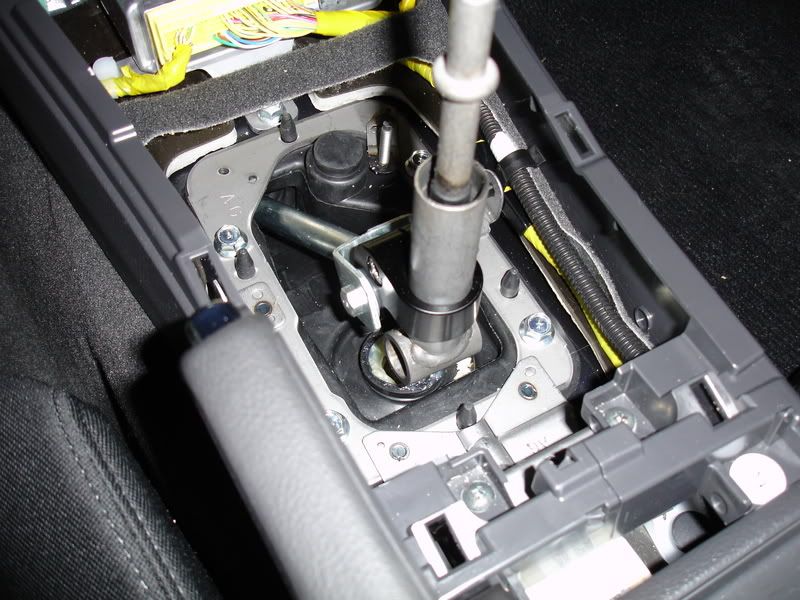

Installed:
The current position of the adapter allows for a significant reduction in throws, yet is not positioned high enough as to cause the linkage to contact plate surrounding the shifter. I have no binding anywhere. I could modify the surround plate and adjust the adapter up farther for even shorter shifts, but I am happy where things are right now.
Shifts now are crisper and shorter, but aren't overly notchy feeling. Installation was a cakewalk. I am very happy. If anyone has any questions, please let me know.
