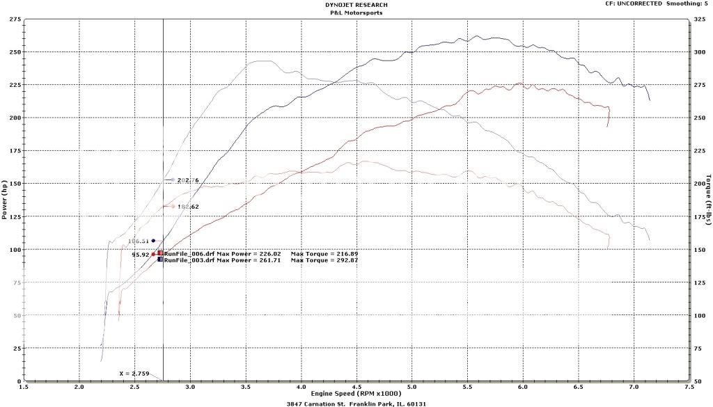

The steelies look very nice. Very conservative tune but I like the plot. Most people would ask me to get highest average hp out of the tune which would result in more of a bell shape and flatter curve with as much power coming on earlier as possible. You have a plot similar to my personal STi. Good approach, easy to drive at WOT.
Here is a sample (not one of mine) of what most people tell me to do:
http://i806.photobucket.com/albums/yy347/cottrilla/STi/dynocomperison.jpg
Basically to peak the torque sooner, and then have it drop off more quickly? That's the only way I could see the hp curve flattening out. The plot you posted has the torque curve peaking at a higher RPM than my car, and it dies off sooner, not what I would want. Power delivery from this tune is smoother and strong up to the top, very nice for daily use. I'm really happy with how it feels around town and on the highways.

Ah, that makes sense. I'd be curious to see the boost, AFR, and timing for that tune.
The torque curve for the baseline run looks a bit off to me. Pretty much flat with the peak at 4.5k
I do agree that that Stage 1 shows about as much gain as my Stage 2. I'm OK with a conservative tune, still is lots of fun!
